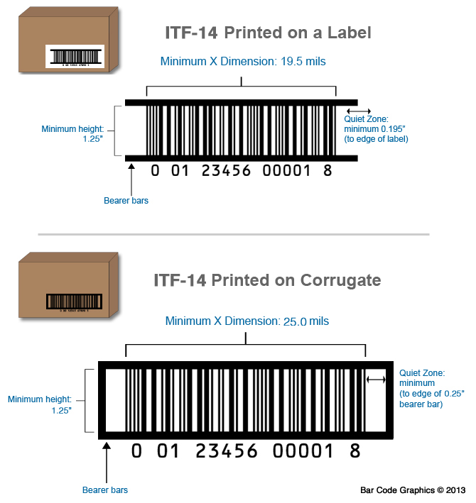

Hi, I'm planning to use your SDK, but i didn't find any information about ITF-14 with bearer bars, it is supported by this SDK ? if not, any plans on roadmap to add it?
ITF-14 Bearer Bar
https://www.gtin.info/itf-14-barcodes/
Thanks!

Current version of SDK does not support bearer bars in ITF-14 barcodes. We will add support for bearer bars in ITF-14 barcodes in next minor version, which will be available in 1-2 weeks.
